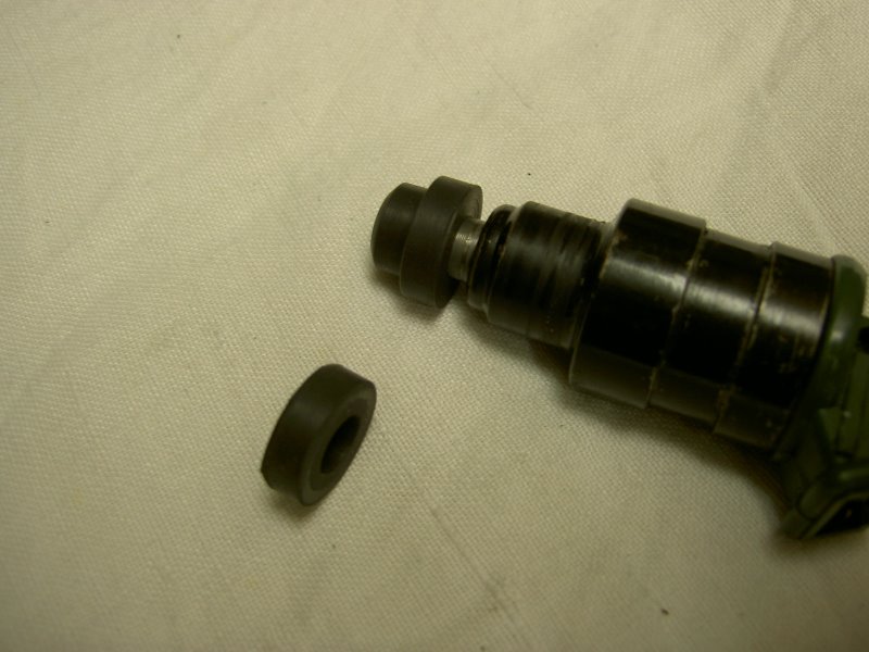

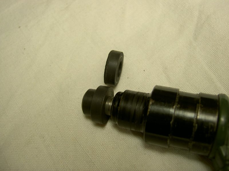

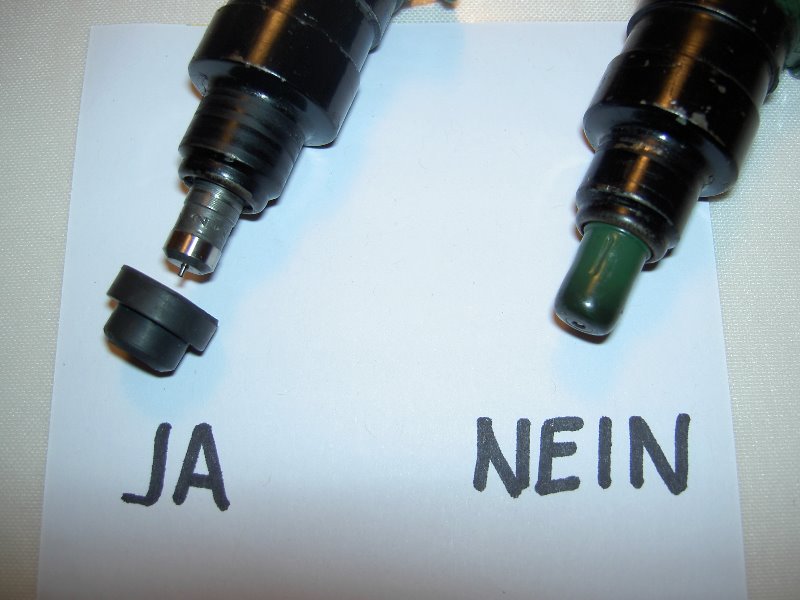

Hi Marcus
Do your injector have the plastic pintle cap on them ?, just where the fuel comes out ?? because we will have the square section seals in stock, but i need to know about the pintle caps, if you do not have those you need them as well to make it possible for it too correctly fit the seals that are made today.
Regards Steve
On 26 April 2016 at 13:18, Markus Schneebeck <markus@herr-schneebeck.de> wrote:
Hi Steve,
thanks for your reply!
The old type 043 doesn’t have the plastic caps, the new ones 036 (replacement type for 043) have the plastic cap! So I would need seals for both configurations!
Do you have the upper seals as well? The bigger ones which holds the valve body in place?
Regards,
Markus
From: steven Biggs
Sent: Tuesday, April 26, 2016 3:02 PM
To: Markus Schneebeck
Subject: Re: Seals for Bosch 0 280 150 043 injectors Citroen SM
You would have to put the pintel caps on the old ones, so the inlet seals fit because they do not make the seals for the older non pintle injector, Bosch decided very quickly in the early day to put the pintle caps on so as to protect the pintle needle from damage.
So how many pintle caps do you need for the old ones ? how many inlet seals ? and how many large clamping bushes ?
Regards Steve
On 26 April 2016 at 14:10, Markus Schneebeck <markus@herr-schneebeck.de> wrote:
okay, finally I understand why the old ones are not available anymore and why everyone offers only the newer ones (but without the pintle caps). Thanks for the enlightenment! ;-)
I need two sets of 6 (=12) inlet seals, one set of 6 pintle caps and two sets of 6 (=12) clamping bushes!
Regards,
Markus

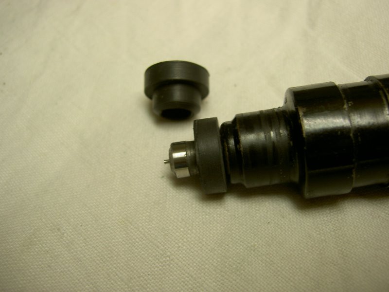

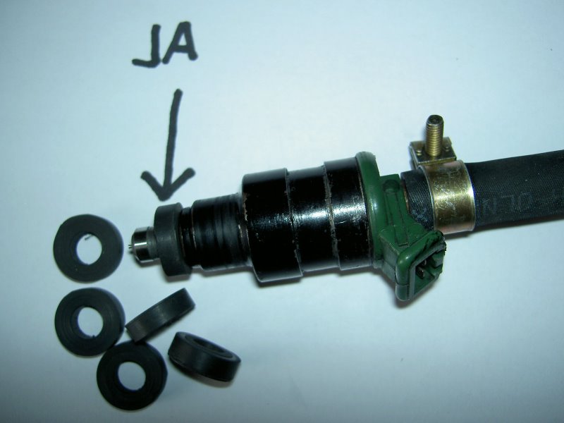

ich habe jetzt endlich eine Option bzw. einen Lieferanten für Einspritzventil-Dichtungen in GB gefunden. Steven James Biggs at
www.mrinjectoruk.co.uk
Er hat Dichtungen für die Ersatztypen 036 mit 9mm Innendurchmesser und genau die kann man auch für die älteren Typen 043 verwenden, wenn man auf diese die Schutzkappen, die auf den neueren Düsen drauf sind, aufsteckt. Habe damit gestern meine Düsen ausgestattet und es passt gut. Der untere Dichtring ist mit 14mm einen halben mm kleiner, das weitet sich dann aber auf 14,5 mm, wenn man die Düse mit der Kappe einsteckt.
Düsen lassen sich leicht einsetzen und Motor läuft sehr gut damit.
Für einen kompletten Satz mit oberen Dichtungen, unteren Dichtungen und den Nachrüst-Schutzkappen hab ich knapp 30 GBP bezahlt, also durchaus okay, find ich.
Die Herstellung eigener Dichtungen bei meinem Händler vor Ort habe ich ja auch angefragt, dort würde die Form für die Dichtungen 310€ einmalig kosten, und jede Dichtung dann bei Abnahme von 200 Stck. 5,61€. Material ist speziell ausgehärtetes Viton, das kommt extra für 24h in einen Ofen und wird dort nochmals "gebacken", deshalb auch der hohe Stückpreis. Kein Schnäppchen also, bei höherer Stückzahl würden die natürlich günstiger, aber da es ja so viele SM nicht gibt, wird sich das wohl nicht rentieren.
Aber die Mr. Injection Alternative ist, denke ich, etwas, mit dem man sehr gut leben kann, zumal es beide Düsentypen 036 und 043 abdeckt.
